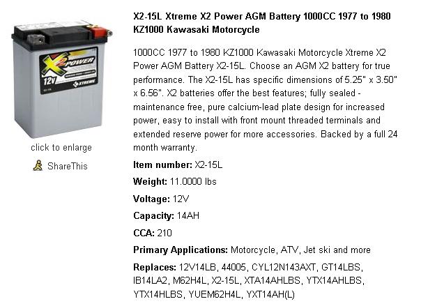

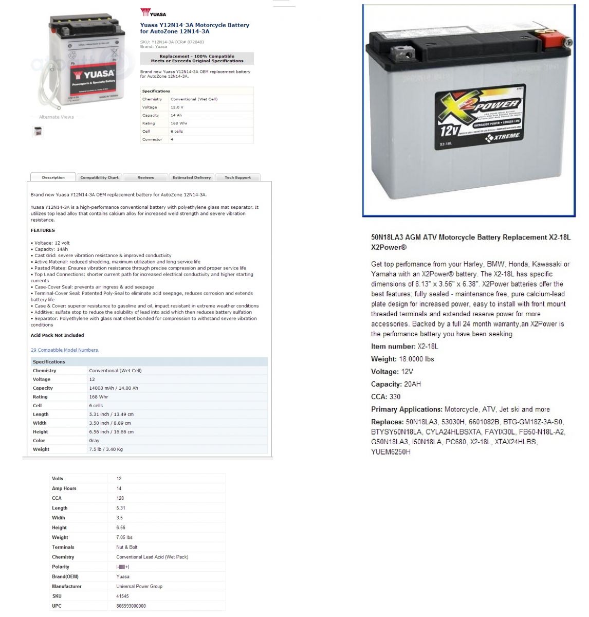

AGM in a heart beat....
First one lasted here in AZ heat for over 4 years... It was still operating but since I re-did my battery cage on the last re-build figured after 4 years, time for a new battery...
Pro's:
* Totally maintenance free.
* No acid spill on battery cage/frame/electrical connections etc...
* Increased Amp hour & cold cranking amp ratings pending model you choose.
Con:
* Cost more (but last 4 x longer)...
Truly a no brainer Ed....
I got mine at Battery Plus Stores... X2 Extreme Batteries...
For the KZ1000 battery cage:
For larger fabbed cage: Note AH & CCA differences... :evil:
