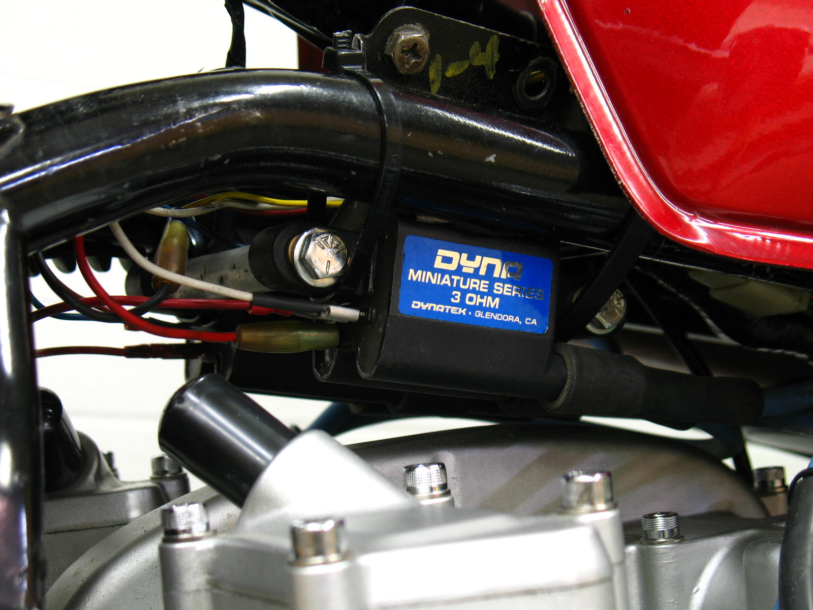

Here's what is beneath my KZ1100-A2 gas tank, nessled between the frame rails, just above the J-motor.
If your frame setup is the same, perhaps this may help. :)
