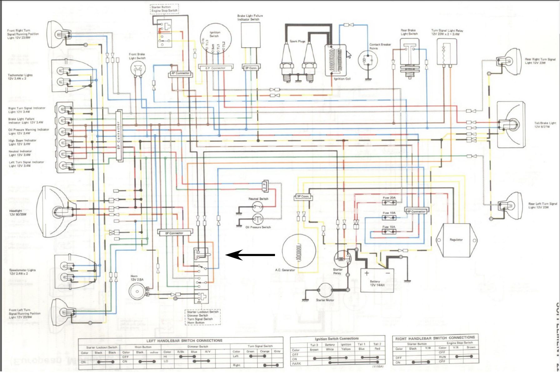

Alright i hardtailed a kz750 over the winter and its down to wiring, but im pulling my hair out. what i did was use the stock wiring diagram and just whited out the stuff i wouldnt be using. the lights work fine, but the start button gives me no action. any ideas? or anything i should be checking. and i can't tell from the diagram how the start button grounds? any help would be huge

This is the exact diagram I have been following. I do have that clutch switch tied in correctly. I don't see where the push button/ engine switch grounds? I know on other projects I had issues with proper ground... could this be the problem here as well?

The push button does not ground. It sends 12v to the starter solenoid's coil. The other end of the solenoid's coil is grounded.
The 12v goes to the solenoid's coil via a black wire, then solenoid's other connection is grounded via a yellow/red wire to the main ground wire.

That answers that question, I am at a loss for what to do. I have all that wired correctly. It has to be something dumb, the bike operated flawlessly in the fall when I stripped it for the hardtail.

Well boys thanks for all the input but I discovered a problem. I unwrapped the ground wire coming off the battery, where there is also a wire tied in to ground the starter and found 2 strands of the stranded wire still connected. I reckon those 2 strands werent offering enough ground. I will pick up a new connecter tomorow and hopefully have knees in the breeze very soon.
