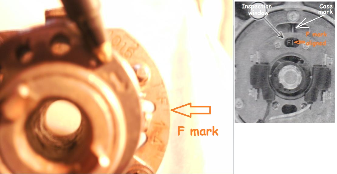

Re: Ignition Timing Specs 1980 KZ1000 B4......HELP
16 Feb 2013 02:00
F mark may appear differently among advancer models.
At idle rpm, assure the F MARK is aligning, not the letter "F."
The following user(s) said Thank You: Tulsa74136
