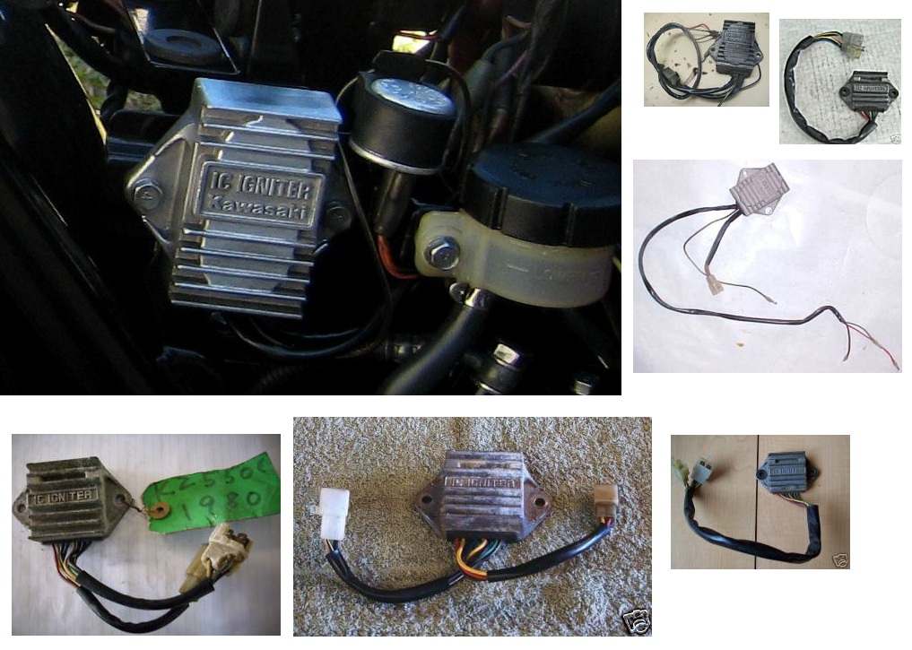

10 Dec 2012 02:18That's the stock Kawasaki electronic ignition.
Operates in conjunction with an I.C. Igniter, a separate unit mounted elsewhere on the bike, usually under a side cover.
Points ignition was used on the large Kaw fours through the 1978 model year.
The electronic ignition with igniter was introduced on the 1979 KZ1000-A3.

This is the type of ignition that has the mechanical ignition advancer, so if the IC Igniter goes bad, you can make a suitable version using "Loudhvx's" GM modules.

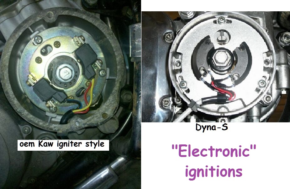

10 Dec 2012 02:51 - 10 Dec 2012 02:53Or easily convert to Dyna-S, if desired.MFolks wrote: This is the type of ignition that has the mechanical ignition advancer, so if the IC Igniter goes bad, you can make a suitable version using "Loudhvx's" GM modules.
Dyna-S fits under the points cover, and doesn't use the igniter.
As reported by some very knowledgeable persons, a properly functioning Kawasaki electronic ignition is in some respects "superior" to the Dyna-S ignition.
