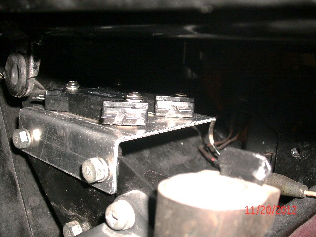

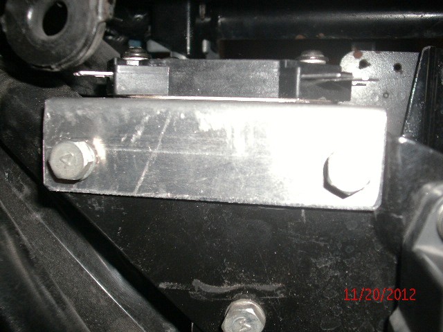

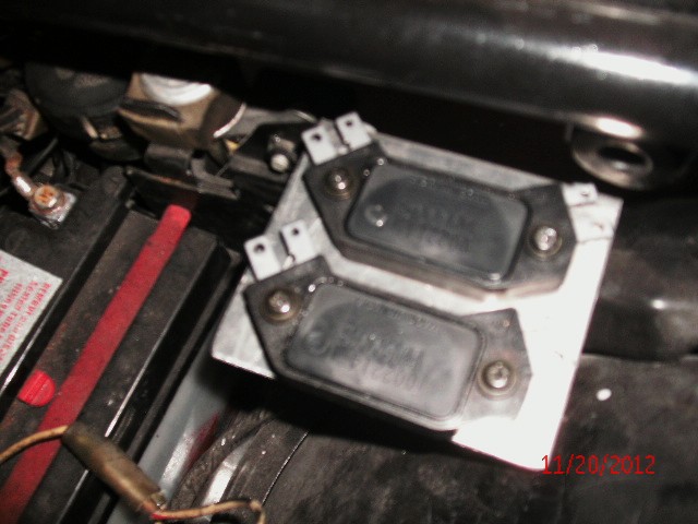

Here is what I decided to do as there was little room to mount them vertical.
Made a 4" x 3 1/2" aluminum plate and put a 90* bend in it so I could mount the units on top with plenty of room and air flow. I don't have any thing wired up yet, but should have it done sometime this weekend hopefully.

Looking good.

Don't forget the heatsink or thermal grease that came with the electronic modules. It helps in heat transfer.

Ok, I was thinking of putting a small heat sink on the bottom of that bracket directly beneath the modules, or would that be overkill?

It would probably work. but will make wiring more difficult, unless you use a pre-wired connector that would plug in to the needed circuits.

21 Nov 2012 04:22I've been using the same, original prototype I slapped together 7 years ago... the one in the photo on my website. No issues so far, ...not even a hiccup. The resistor and two diodes were just soldered wire-to-wire and wrapped hastily in electrical tape.badrhino wrote: Ok, I was thinking of putting a small heat sink on the bottom of that bracket directly beneath the modules, or would that be overkill?
loudhvx, are you still running your set-up? How long have you been running it and have you had any issues?
With the aluminum plate as you have it, the modules should only get slightly warm. Any more heatsinking is probably overkill.

Glad to hear it is still going strong. That's what I wanted to hear. Yeah I'll prob. skip the heat sink as it would involve more work. lol :silly:
