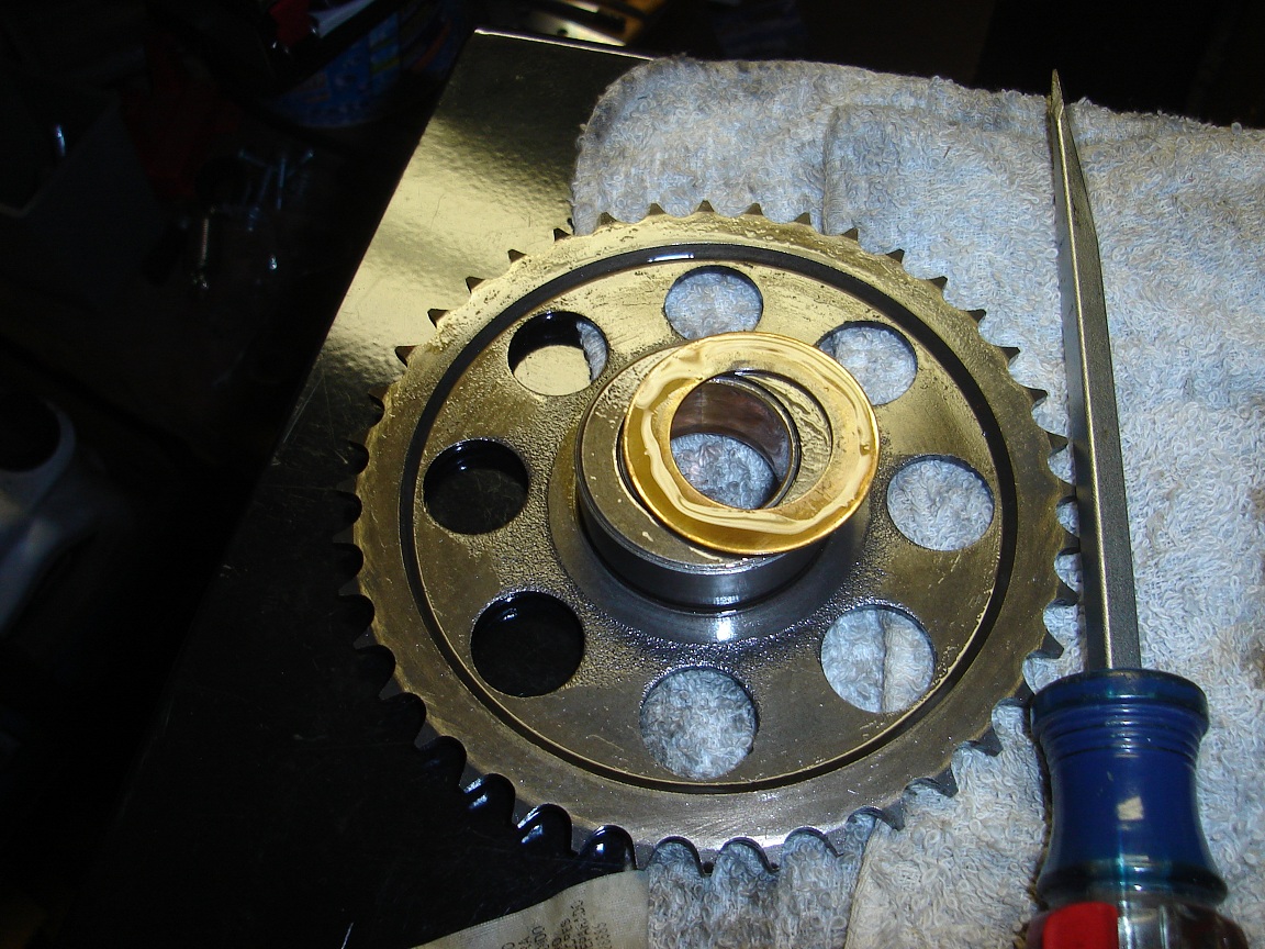

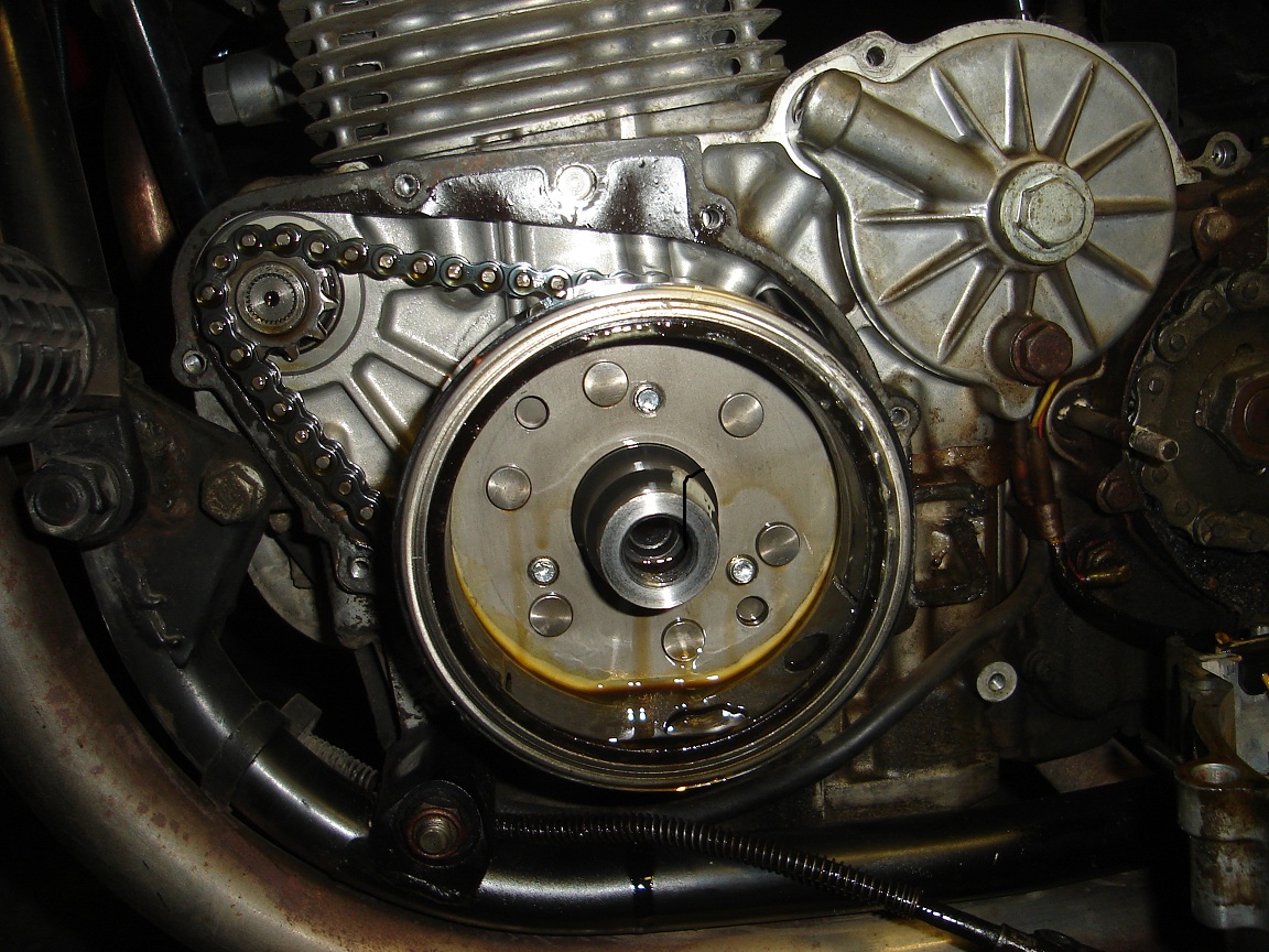

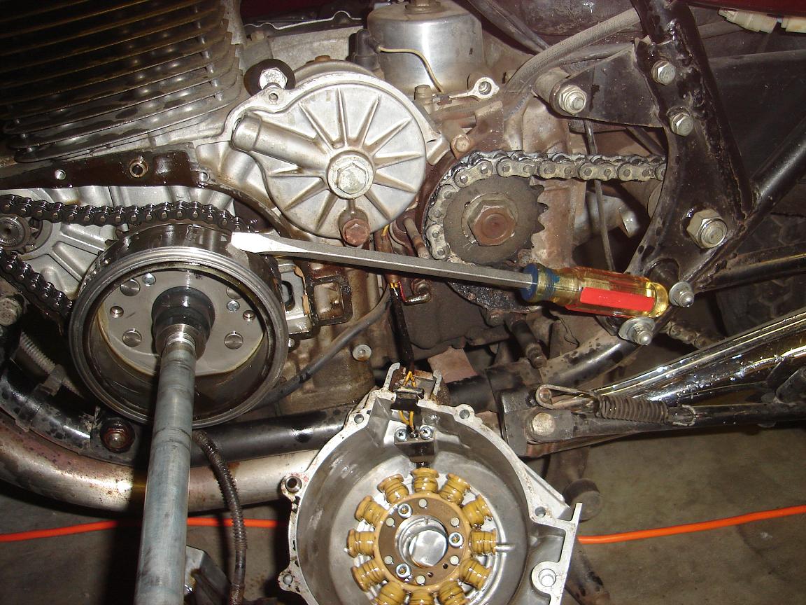

Topper, fly wheel puller threads into the RH threads in the rotor and pushes against the end of the crankshaft that has the LH threads for the LH retension bolt
the thrust washer, note located between starter gear and flywheel
don't forget
or you WILL be doing it again.
And when you get the urge to check the starter before replacing the cover, well the bike, work area, cloths, etc. needed cleaning any way.
don't forget

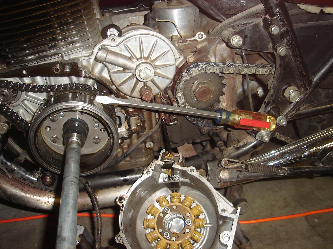

Pulled my rotor and starter clutch today.
I'd seen many suggestions for improvising a flywheel holder, including Rainman's big screwdriver pictured above. But none of them to worked for me.
What did end up working was a strap wrench. I had to clean all the oil off the flywheel with a a little mineral spirits, but that did the trick.
