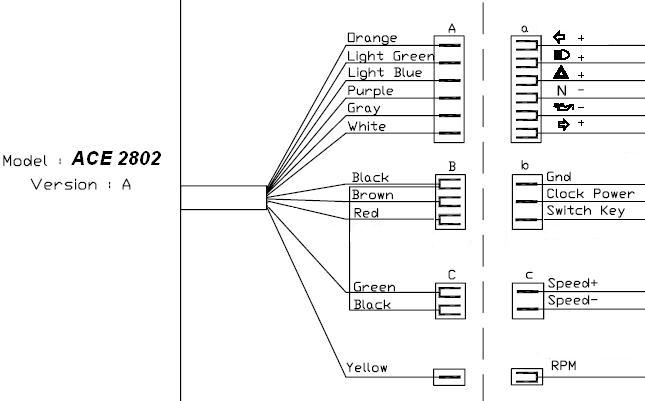

I have been looking at this Acewell 2853. How would I be able to get a wiring diagram from the gauge cluster so I can hook everything up correctly? Any experience with these products? I have used Dimecity before and was very happy.

Bumping to top. I am still very confused on what kind of tach I need. Mine is electrical. I have looked quite a few different ones, but keep seeing ones with only a few wires, and some with many. Could someone explain how to hook up a tachometer and what each wire does? Thanks

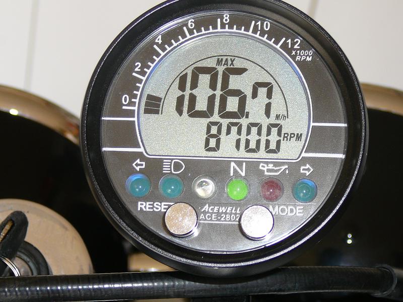

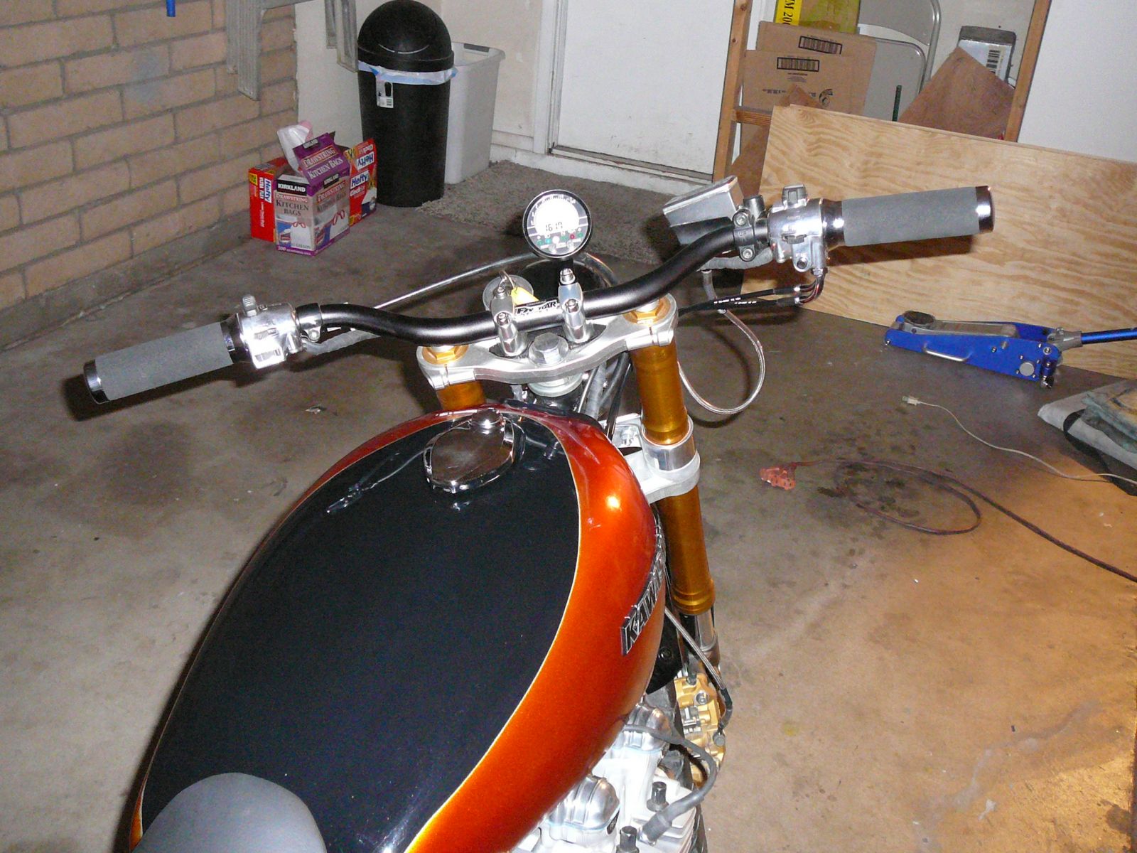

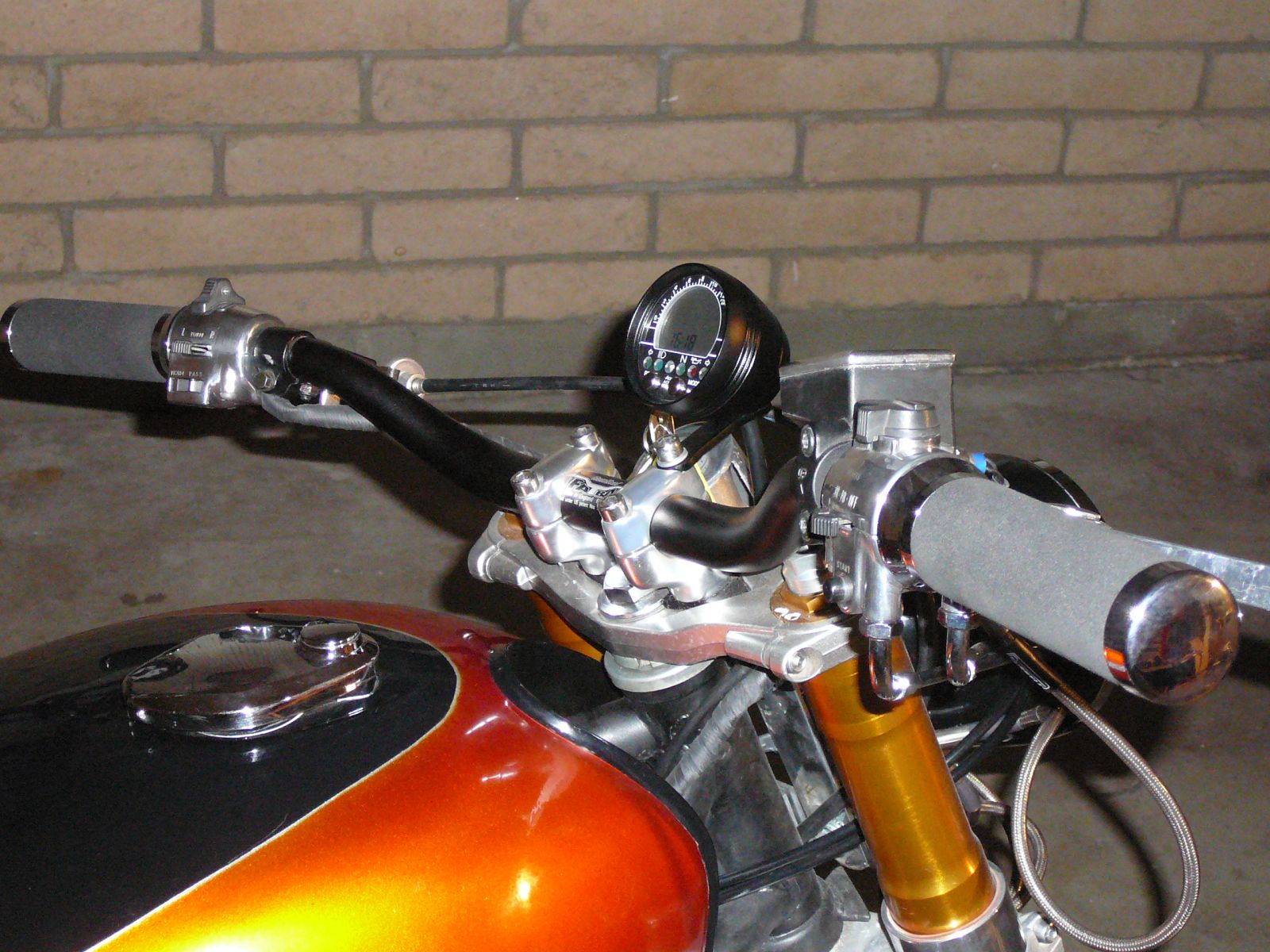

My Acewell 2802... Use second trip meter as your mpg/fuel gauge... 120Miles, time for refuel!
Extremely small profile.... LUV it, thing works sweet no issues what so ever.... Highly Recommend!
