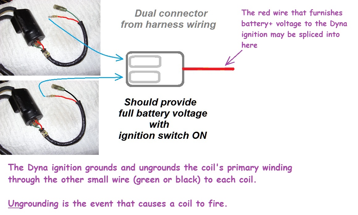

Hello everyone been a memeber a little while now this would be my first post. Had a question about
my coils i bought the Dyna S 2000 setup with coils and Pulser. My bike is a 1988 Kz1000p starting all fresh with the wiring, so i have my dyna ignitor box and coils in. The red wire that i guess sends power to coils that you are suppose to run to the ignition as well. Does this red wire go to both coils or would just one sefice? Included some pictures let me know what you guys think?
Thank You Mean it

Re: IceBreaker Post
11 Sep 2012 20:08
#548100
Good Fortune! :)
