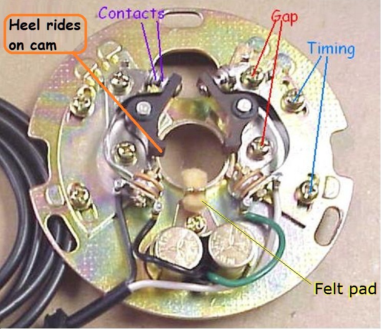

Wait a minute , z1kzonly you say to gap them at .015-.020
The shop manual says .3 -.4 mm which is .0118 - .0157 in.
I set them a little loose with a .330 mm or .013 in. and I'm getting a little pinging at low to medium rpm. when I push it.
I need to find my file. :side:

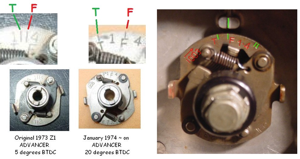

First, dress the contacts, set the gap, and clean the contacts.
Then adjust the timing.
Be certain of the F mark. Don't use the T letter or the T mark , or the F letter.

Thanks guys, Z1E still is the most reasonable place for points but I decided to work on cleaning up the ones I've got.
So I went back to the 400 sand paper folding over so I worked on both surfaces at one time and let the pressure from the spring hold it closed on the paper while i moved it around in kind of a circular motion .
Set the gap at .019 cleaned them off with acetone and checked the timing ( still good )
She's running fine.
I think the pinging was from 87 octane on a hot day by mistake. :pinch:
Got 89 in there now ,no more pinging
She's running fine.
