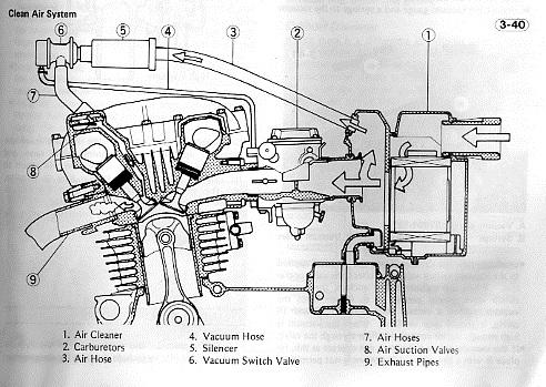

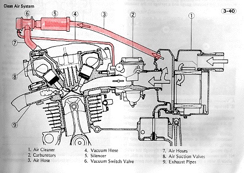

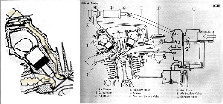

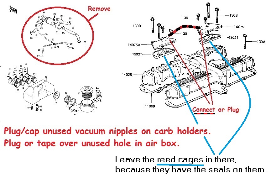

A little update, between the storms that rolled through here I was able to get a better look at the bike. Turns out, carbs 2&3 are plugged, but carbs 1&4 have these hoses on them.
These hoses go into a tee:
Then from there go to this at the front of the bike:
This is has 2 hoses going to the valve covers, then a hose that goes all the way back to the airbox.
Here is an expanded view:
Am I dealing with emissions here? Would I be able to plug all this up and get rid of it?
