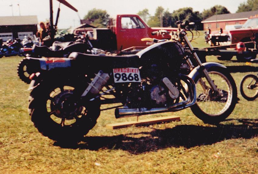

I ran one on a rat bike dirt dragster to have fun. 2 wires pos and neg and a battery! it light it up!!!
