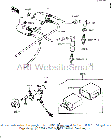

I have a problem. My 1984 ZN1100 quit sparking on 2 and 3 cyls. I replaced the coils with some new Dyna coils but still no spark. I thought I would replace the igniter and, with some help from a forum member, found some 211191071 igniters for sale on ebay. Then I thought maybe better to try and find new one. I checked with Z1 enterprises and was told that I should have 21119-1104 igniter. So which one is it? I wonder if my ignition not having points might be the difference but don't know for sure.The bike was running super and then started barely running and now won't start. After this lon winded post can any one suggest something? Thanks in advance

Yours is the 21119-1104 IGNITER. Before you asked for a specific part # in your post. but if you look at the parts fiche, you will see there is no Mechanical advance. So the advance is in the IGNITER unit.

Thanks, I knew it didn't have a mechanical advance but I just went off the part number of the igniter that was on the bike. Will having the wrong igniter make a difference? Before the bike quit running it was running real good. Thanks for the help
