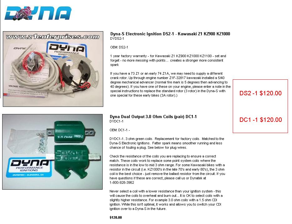

I have a 1977 KZ1000 LTD. Getting a dyna S ignition. What coils do I get?

Assuming Dyna-S ignition, 3 Ohm coils (Green) and get new Dyna plug wires w/caps.
NOTE: Insure to inform Z1 for example which Advancer unit you have on the bike....
Dyna-Ignition plate slots are slightly different!
Dyna 3 Ohm Coils
Dyna 3 Ohm Coils
