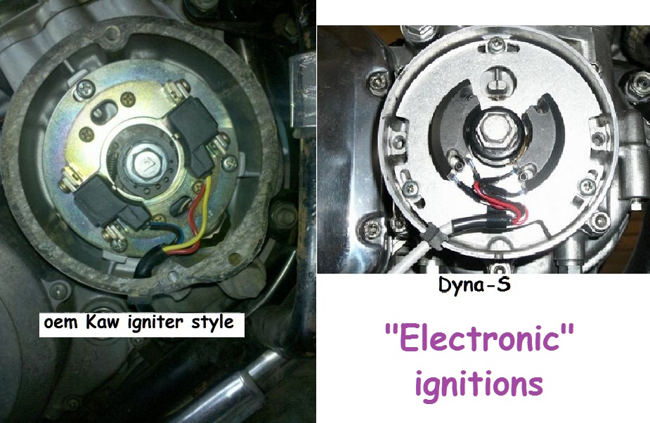

What ignition is currently fitted? Points? Stock Kawasaki with igniter? Dyna-S? Something else?

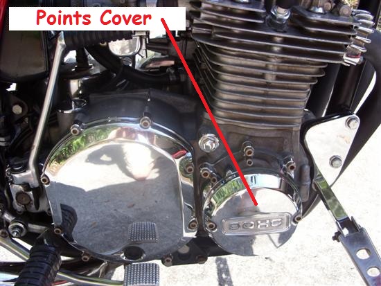

If uncertain, take a look under the points cover.
See points?

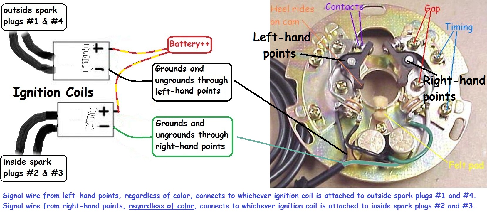

Or maybe see one of these?
