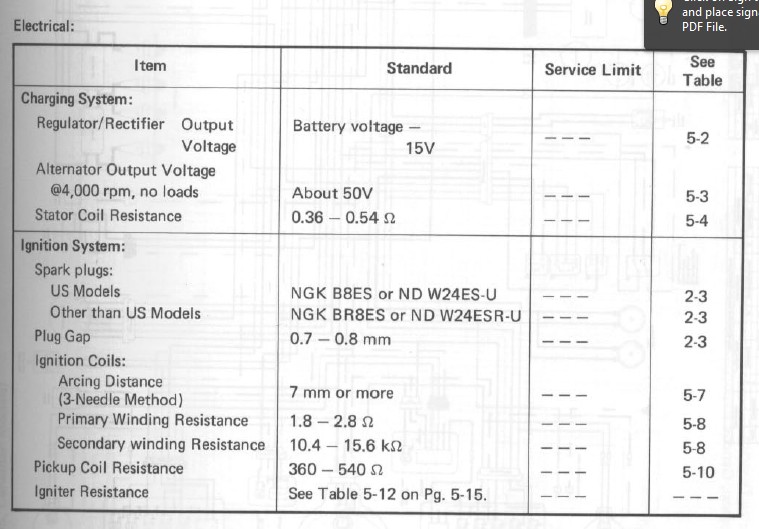

I'm using the 3 ohm Accel coils. here is an out take from the Factory Manual for the K1-K2 CSR etc with Factory Electronic Ignition.

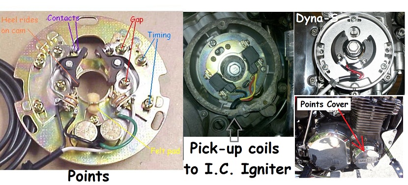

The best coil resistance with depend on the type of ignition
Could be points or Kaw igniter or Dyna-S or some other type of ignition.
If in doubt as to which type of ignition, may look underneath the points cover.
