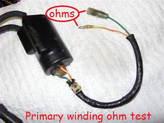

10 Jun 2012 09:35Tulsa74136 wrote: ...how do I measure the resistance of my coils....
Use an ohmmeter to measure resistance (ohms) through the primary winding inside the coil, which is between the two terminals.
