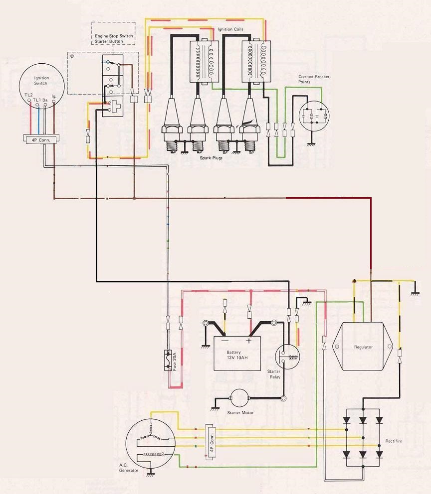

Hey all, newbie to the kz but not to bikes. Picked up a project bike that someone seemingly lost the key and butchered the switch. Can anyone assist with which wires to jump to activate the stock ignition? Searched around and I know I can have a key made but it looks like the original switch is spent. If the bike runs then I will probably be relocating the ignition so I don't want to waste money on the stock stuff. Any help is appreciated. From what I see its a 6 pin connector with a single separate brown wire out of the connector. Thanks again.

You can find your wiring harness by clicking FILEBASE in the upper right hand corner of this page.
It looks like connecting the White, Brown, and Yellow wires will power up the ignition.

All depends on what your trying to accomplish such as starting/running only, include lights etc... For power to starter button, starting & testing engine, white to brown through N.O. (Normally Open) 20amp switch more then enough....
Maybe this will help, may be a little different then your actual wiring but should be close to give you the idea.

I am guessing from the diagram I will need to jump the single brown wire outside of the connector to the white and yellow. If I am reading that correctly that should give me what I need to juice the coils and get the starter working? I think once I am confident it runs I can test out the lights etc by jumping according to the diagram.
