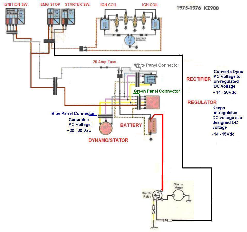

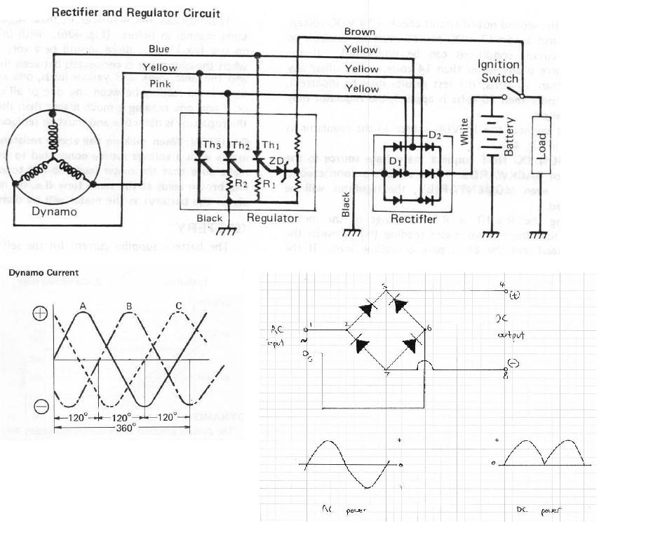

Maybe this we will help... for better undertsanding
