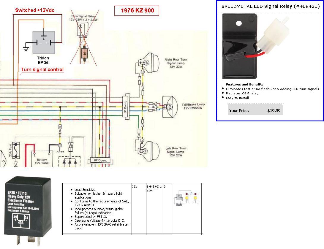

- Old Man Rock
- Posts: 6074
- Thanks: 225
Re: LED flashers ?
26 May 2012 10:09
