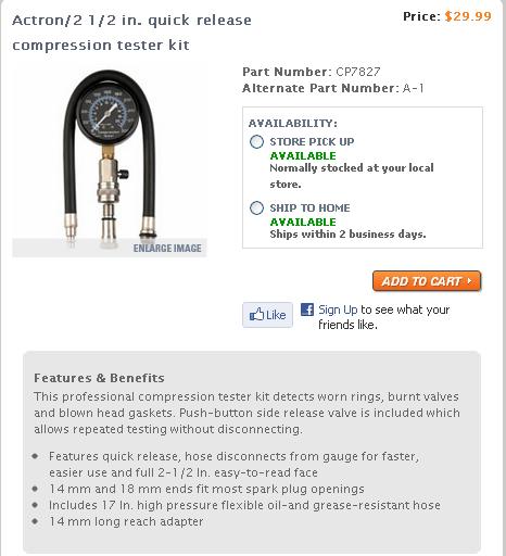

Some auto parts stores, such as Auto-Zone for example, will have a compression tester that they loan out to customers.

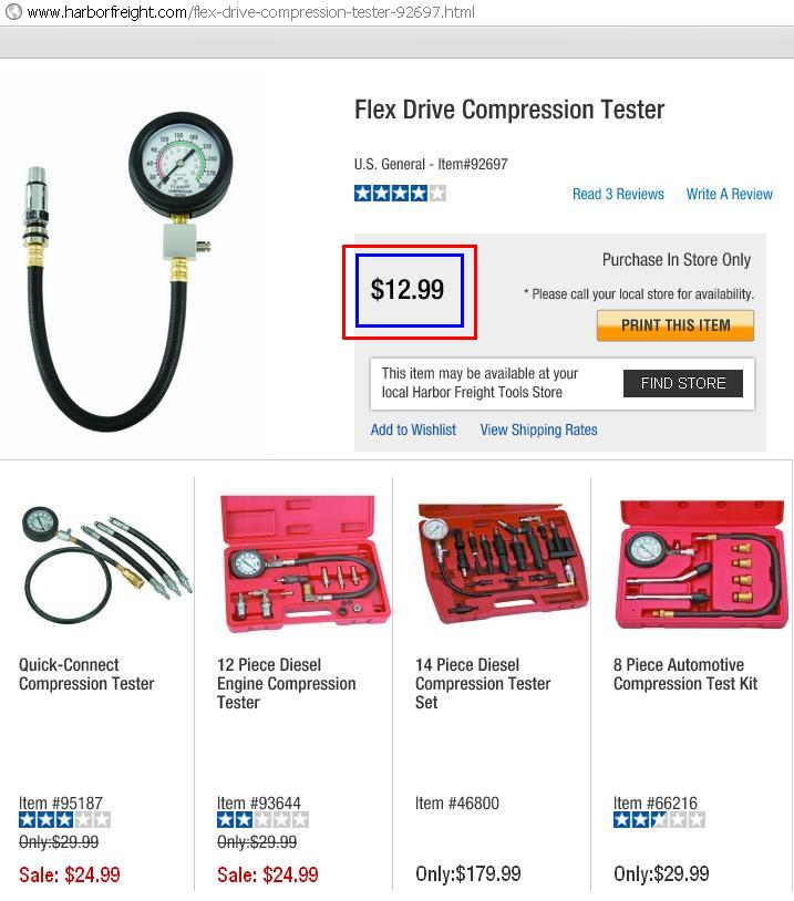

Auto Zone has them for ~ $30....
For rair use, HF Tools (if in your area) has them in various price ranges, @ $13 this will work well enough for diagnosing compression loss, even if off a pound or two in the measurement...
