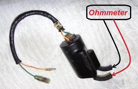

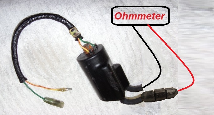

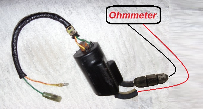

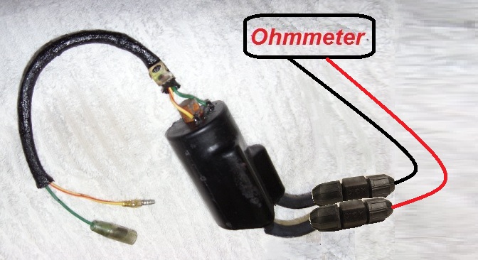

22 May 2012 10:42Would remove splicers and re-test resistance in secondary winding by measuring ohms with meter probes touching wire cores at ends of stubs from coil.badrhino wrote: Why would they sell these types of wires packaged as they did if you can't splice into them. They came as two wires and you had to cut them in half to make the four.
Then refit just one splicer and re-test.
Then re-fit the other splicer, and re-test.
This testing should show whether one of the splicers is affecting resistance through the secondary wiring.

22 May 2012 11:13badrhino wrote: ...was still not getting any readings at the plug caps. I unscrewed one end of the splicer and tested from the splicer on both coils and got readings. Below is what the readings were. Are these in spec.?
Left Coil
Primary 1.9 ohms
Secondary (at splice) 15,100 ohms
Right Coil
Primary 1.7 ohms
Secondary (at splice) 15,800 ohms
Now my question is.....why am I not getting anything past the splicer? These are new wires.
These readings look okay, because the coils seem very comparable to each other.
Could be mistaken, but thinking it's okay to use the splicer for connecting solid-core wire (from coil) to new resistor-style wire. Am seeing nothing to indicate otherwise in NGK's website where the splicer is described.
However, it's of course necessary that the splicers be correctly installed. But I don't know how much of an issue that might pose. Or whether there are any fitment instructions available..

22 May 2012 11:57Patton wrote:Would remove splicers and re-test resistance in secondary winding by measuring ohms with meter probes touching wire cores at ends of stubs from coil.badrhino wrote: Why would they sell these types of wires packaged as they did if you can't splice into them. They came as two wires and you had to cut them in half to make the four.
Should all measure the same resistance, with or without the splicers, or with only one splicer.

I am getting around 15,000 ohms at the end of the splicer. But when I put the wires on and test the end cap I am getting really high readings like (Left: 74,000) and (Right: 24,000) It makes no sense. Shouldn't the readings be around 5,000. And why would the readings go up instead of down?

22 May 2012 18:23 - 22 May 2012 18:26badrhino wrote: I am getting around 15,000 ohms at the end of the splicer. But when I put the wires on and test the end cap I am getting really high readings like (Left: 74,000) and (Right: 24,000) It makes no sense. Shouldn't the readings be around 5,000. And why would the readings go up instead of down?
More resistance results in higher ohms. Less resistance results in lower ohms.
Measuring between the splicers shows resistance in the secondary winding inside the coil. And should be the same as measuring the resistance between the cores in the stub ends without the splicers.
Measuring between the caps adds the resistance offered by the resistor plug wires.
24,000Ω on the right is probably okay.
But 74,000Ω on the left seems way too high (perhaps due to faulty connection through the splicer).
For comparison, the stock Z1, with solid core (non-resistor) plug wires and resistor caps, is supposed to measure about 30,000Ω when measured cap to cap, which would include resistance in the secondary winding plus resistance in the stock resistor caps.
Measuring between the plug wire leads, without the resistor caps, would be less resistance.
