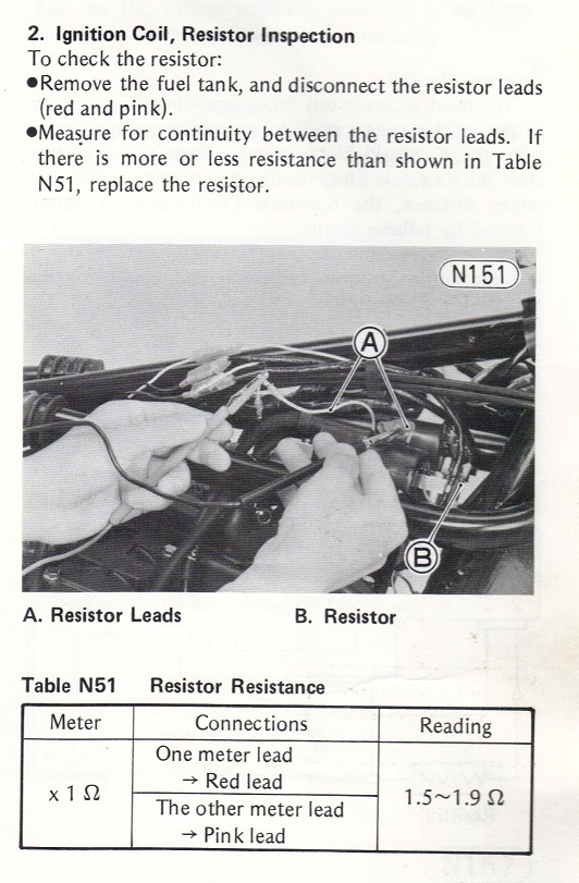

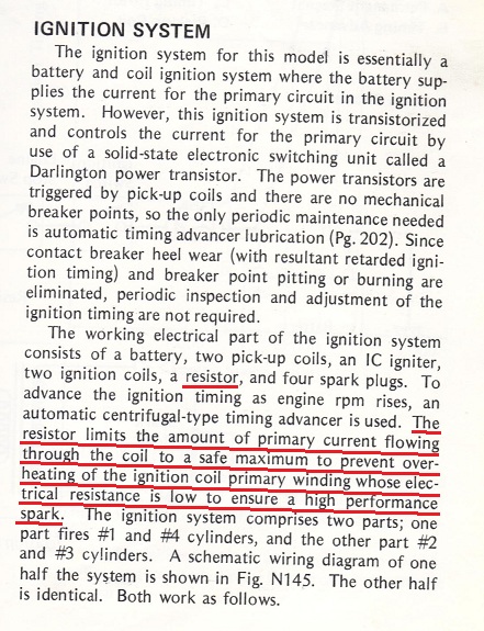

The former point ignition on 1978 KZ1000-A2 was superseded by an electronic ignition on the 1979 KZ1000-A3,
Here's what the FSM says about the resistor:
