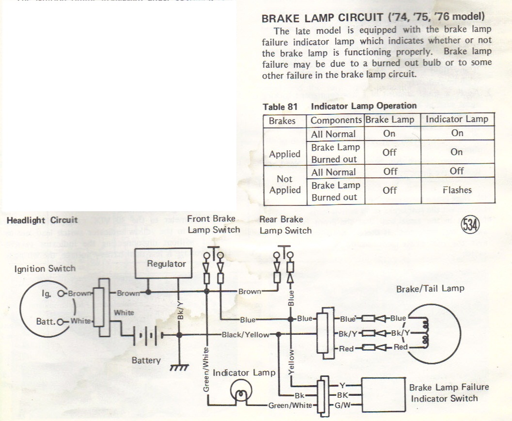

As known, the brake-light-warning idiot light is supposed to remain dark while cruising along without any application of either brake.
During brake application, the idiot light is supposed to burn a steady bright red.
(This lets the world know that the idiot light bulb and its related circuitry are functional).
Here's the "warning" part:
When the rider notices the idiot light is "blinking" when supposed to be dark while cruising along without either brake applied, the "blinking" idiot light is warning the rider that "the next time brake is applied, the rear brake light ain't gonna light up."
Such warning typically results from a blown brake light filament in the rear bulb, but may also result from other deficiencies such as a bad wire, loose connector, etc.

Thanks Patton I have a prob. Mine is intermitant sometimes the brake light comes on with the front brake sometimes not. very good diagram

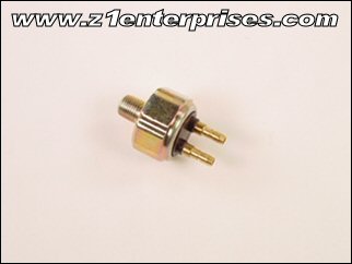

07 May 2012 23:25While there might be an issue with the pressure switch itself, would first assure that the connections where the wires attach to the switch are clean and snug, and that neither wire is frayed.STRATOCASTER wrote: ... intermitant sometimes the brake light comes on with the front brake sometimes not....
If needed, here's what a typical pressure brake looks like, usually being located in the steering head area.
