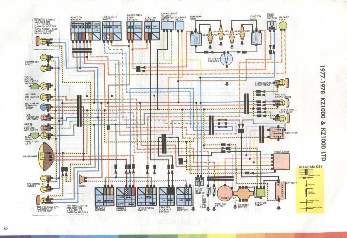

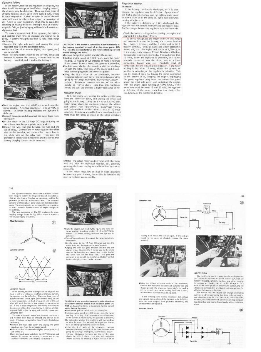

Starter lockout switch opened due to excessive current...
Electrical test for KZ900... Up to 1980 & pending models, shared the same charging system for the most part so should be the same... Someone with a wiring diagram/electrical test procedure you can share, please do so....
Z1/KZ900 electrical Test:
1977-1978 Wiring Diagram: KZ1000

18 Mar 2012 21:19Old Man Rock wrote: Starter lockout switch opened due to excessive current...
I believe the 79 has a different wire diagram. does this mean the charging system is different?
