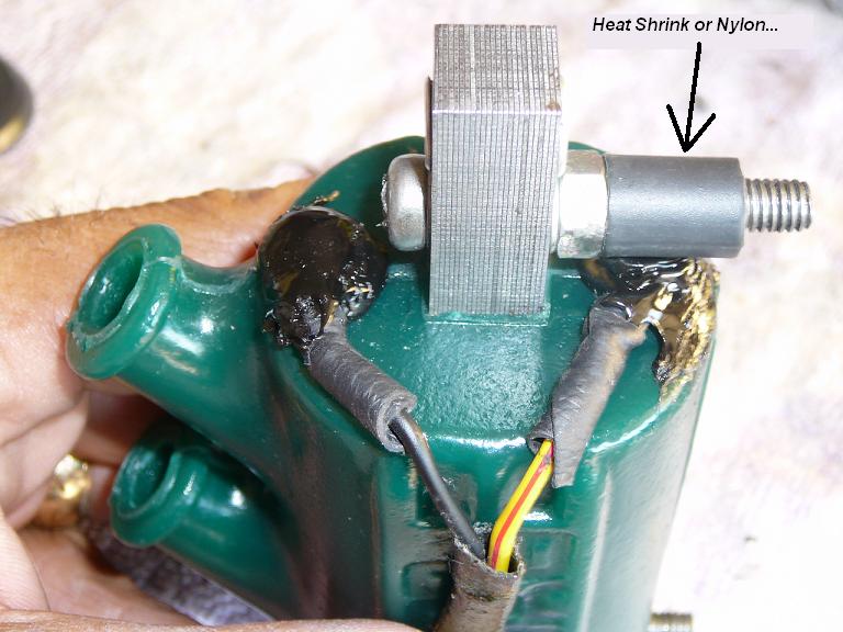

If wiring is correct then are you sure the coil mounting post(s) isn't shorting to the +12Vdc(battery) terminal?
Just in case...
Just in case...
Attachment DynaSBenchTest.JPG not found
