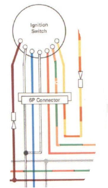

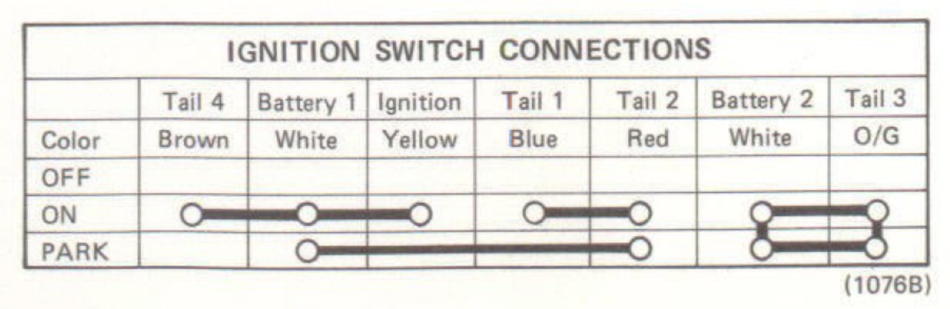

So all the tumblers are broken in my ignition and i bought an after market one and i was wondering which color wires flow power to the ignition and which ones don't? because i need to wire up the aftermarket one i bought and don't know which wires put out power. I could test them but id rather find a answer on here before tearing into it. Thanks. I believe theres 6 terminals 2 white 1 blue 1 brown 1 red 1 green/red stripe. question is which one puts power

Depending on which model 1980 KZ1000, the wiring diagram will probably show the ignition switch something like this:

And this:
