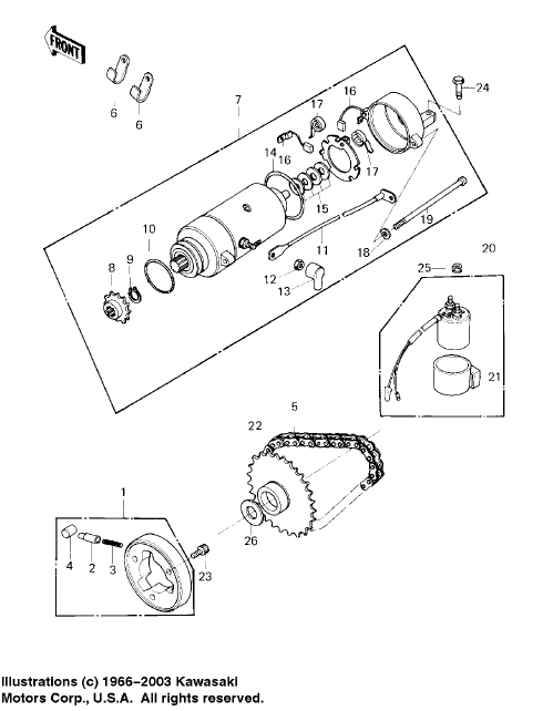

no marks inside cover or stator...the only place that may be marked is side of engine wher starter chain may have hit,,,right on top of the big sprocket.....with everything installed and tourqed, the big sprocket has some play...Is this normal...also does starter sprocket install with long side first...that is how I read manual....but exploded view shows sprocket by itself with long side away from starter.....I'M CONFRUSSEDD!!!!!

my starter gear spocket is correct,,I'm asking about the small sprocket on the starter....does the long side go toward the starter motor, or away from the starter..

If not already done, the parts diagrams at kawasaki.com might be helpful.
Here's a link toward navigating the site and finding information.
kzrider.com/index.php?option=com_kunena&...w&catid=13&id=376734

in the diagram the small sprocket (has one side flush one side portruding) looks like it should mount on starter shaft with flush side first,,,,,,,but in installation manual notes, it says portruding side mounts first....I'm still confused??? I'm trying to dot every I----to locate loud clank sound.

my cover fits perfectly,,,,i have installed new starter clutch...and it still clanks sometimes when i hit starter button. The large starter gear sprocket still has a little slack..the starter chain can be pushed at top of large sprocket and it will touch side of engine it appears to have worn into the metal some..i believe that is sound...I need solution..my small sprocket on starter motor is installed with flush side against starter motor as pictured.....(but in manual installation notes, it stated portuding side goes on first) My sprocket teeth are sharp, and chain seems a little loose. POSSIBLE SOLUTION:There is no shim pictured between large sprocket and engine maybe put one...File away the two areas on side of engine where chain hits. Try to locate both starter sprockets and new chain. any suggesions welcomed
