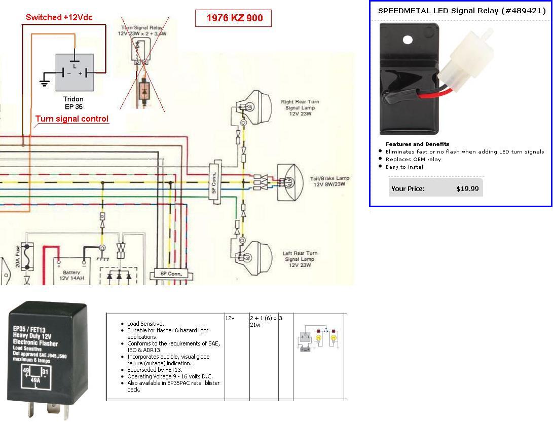

Thanks again all...switched back from LED to filiment based 1157 bulb and shazam...all set.
- Old Man Rock
- Posts: 6074
- Thanks: 225
Re: 1978 KZ 1000 A2
29 Dec 2011 10:57
If you want LED, just change out the relay...
Example: LED current sensitive relays, many options, easy to install...
