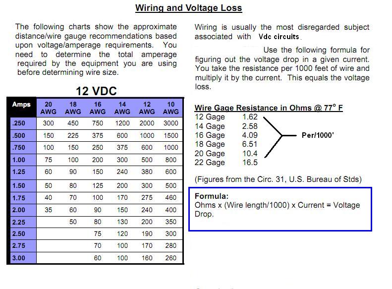

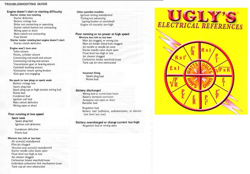

Excessive current being drawn through the fuse... Sure you can go deeper into theory of heat generation, electron flow etc... bottom line, excessive current due to shorted or partial shorted circuit on the load side of the fuse...
Maybe this will add some additional help.
KZ-Electrical Theory
