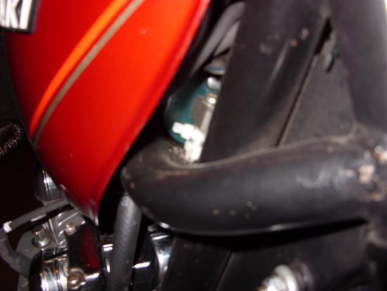

thanks guys. i pulled bike out and started spraying water on componenets. everything looks good except when i sprayed the ignition coils. than bike started missing and shut off. so i pulled tank and looked at coils. they look like they were cracked at one point and a previous owner put some sort off glue on them. apparintly it didnt work. so for now i just try not to ride in rain. bike runs great otherwise so maybe new factory style coils.

15 Dec 2011 23:27My1stKZ750 wrote: ..........so maybe new factory style coils.
Original coils from Kawasaki are expensive. Take a look at Dyna coils from Z1Enterprises.

i checked out Z1 ent. the coils are cheaper than like bike bandit. but they look like they mount different. they look like they mount sideways with the secondary wires facing out. is there room to mount these under the tank. or would i have to make new brackets.?

I am a DYNA fan personally you cant go wrong. they are 130.00 at Z1 E. habve seen used ones sell for nearly that on ebay
Attachment DSC02539.jpg not found

17 Dec 2011 13:47My1stKZ750 wrote: i checked out Z1 ent. the coils are cheaper than like bike bandit. but they look like they mount different. they look like they mount sideways with the secondary wires facing out. is there room to mount these under the tank. or would i have to make new brackets.?
Here's an illustration of a typical fitment on Kawasaki large fours with Dyna green coils attached to the stock coil mounting tabs (pic is courtesy of OMR).
The small wires that attach to the two coil primary terminals are held by screws.
The heads of the screws are often very close to the coil mounting spacers, and may short against the spacer.
It's important to insulate the screw head from the spacer, and to assure that the screw head doesn't short against the spacer or anything else.
I have tie wraps serving as insulation around the spacers on KZ900 LTD.

Looks great. What about using black liquid tape to insulate? I'm gonna go with Z1 coils.

17 Dec 2011 23:27My1stKZ750 wrote: Looks great. What about using black liquid tape to insulate? I'm gonna go with Z1 coils.
Anything that works to provide sufficient insulation should be fine.
Might also consider replacing the metal coil mounting spacers with nylon spacers or hard plastic spacers.
It isn't necessary for the coil to itself be grounded.
The coil would function as usual hanging in mid-air without being affixed to the bike.

Ok so i pulled the coils off 3 days ago. the one coil had a crack running across the back side where it would mount. So i took some black silicone and sealed up crack. and some others here and there on both coils. than i started up bike and sprayed heavily with water from hose. no troubles. I rode bike to and from work last couple of days in the rain and no more ignition problems. cheap easy fix for now.
