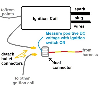

Testing Kawasaki Ignition Coils For Input Voltage
When voltage testing Kawasaki Ignition Coils, the following needs to be done:
1. Remove the fuel/gas tank to access the coils.
2. Fully charge the battery.
3. Using a multimeter, set it up for VDC(Volts, Direct Current), range of 20.
4. Turn on the ignition switch and the run/stop switch to “Run”.
5. Put the multimeter’s RED probe on where the red or red/yellow wire goes on the ignition coil.
6. Put the multimeter’s BLACK probe on either the battery Negative(-) post/terminal or a good frame ground.
7. You should be able to see battery voltage at the ignition coil connection, but this depends on the current draw of other items in the same circuit.
8. If the tested voltage is down to 8-9 volts, you probably need to clean the many and various electrical connectors.
Primary(small wires) side of the coils will read between 1.8 to 3.0 ohms.Check this with the wiring from the harness dis-connected
Secondary(sparkplug wire ports)side of the coil will read between 10.4K to 15.6K ohms. These ports are wired together, so it makes no difference which is used, as long as the correct coil to sparkplug configuration is followed.
The sparkplug caps should read 5K OHMS(5000), any higher, or a reading of infinity means new caps should be ordered.
To stress the ignition coils, take a hair dryer, heat the coils and see if the ohm readings change from cold to hot . If they do, it’s time to buy new coils.

09 Dec 2011 15:35When using the voltmeter, connect the red test wire probe (positive) to the dual connector, and connect the black test wire probe to either the engine head or to the negative battery terminal post.
And remember that a poor connection where the negative battery cable attaches to rear of the engine sometimes causes trouble. The connection might be corroded.
