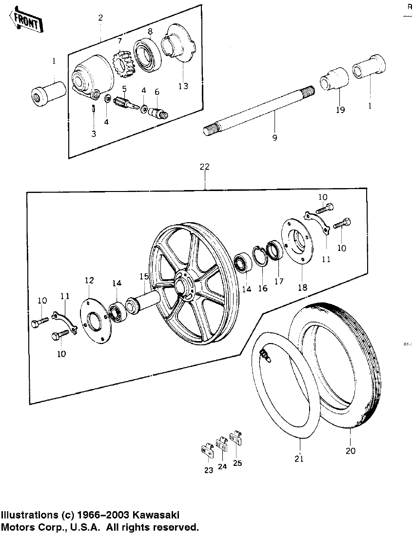

You need to disassemble the front speedo drive hub, or at least pull out the Pinion gear. Looks like this: #5
The pinion gear fits a bunch of models, see if this link works for it: www.kawasakiepc.com/SResultPartIndex.cfm...D=0&PartInfoWindow=1
But a good used assy might be you best choice.
Here is what it fits, again very popular: www.kawasakiepc.com/SResultPartIndex.cfm...D=0&PartInfoWindow=1
Something had to seize up in order to break that, definitely check the cable, and speedo head. You can use a drill, chuck the cable end up in a drill and spin the cable and head. Look at the needle, it should have a smooth reading and be quiet.
