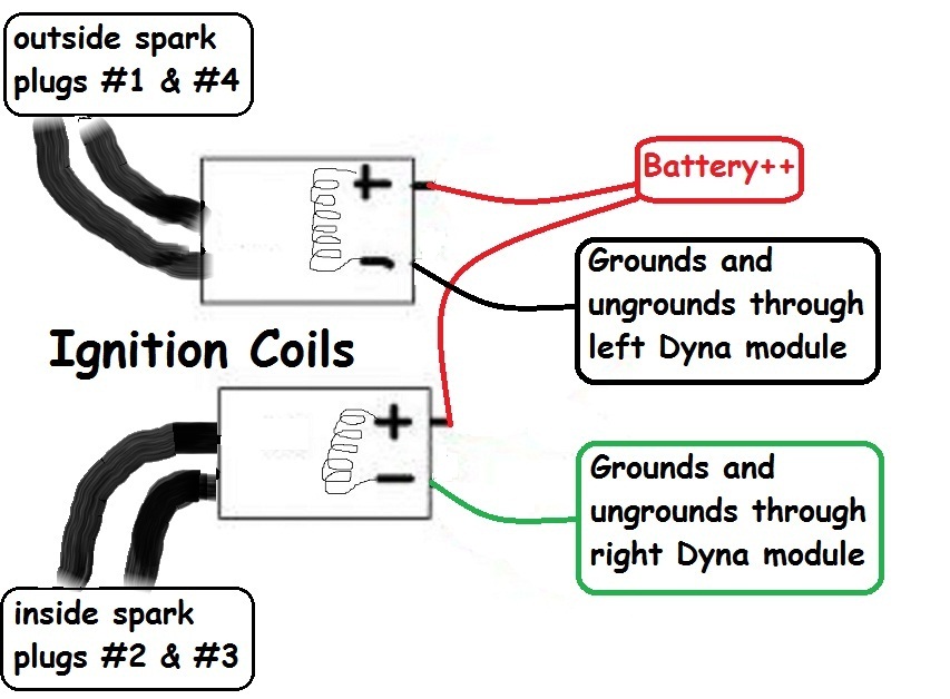

Will give the red (red/yellow ) wire a wiggle and see if Patton nailed it.
And as per "jeffaski" check the wire from the alternator, though if these wires were bad would it affect just one side/coil or all of them?

My bike had a Dyna III on it when I bought it and this is exactly what happened when it started going bad. I was given a Dyna S in a box of extra parts that I got with it. I swapped it for the III and problem solved.

I just had this exact thing happening with pistons 2 and 3
coil tested good
it turned out to be no signal coming from one side of the pickup / pulsing coils
i dont mean to thread jack but can i just buy the dyna pickup plate as seen here?
i hope thats all i need?
:pinch:
coil tested good

26 Mar 2012 18:58Sounds like it has to be the igniter module or the pickup sensors.mac0239 wrote: I put on Flashing Plug Caps that flash red to help me diagnose (plus they look really cool in the dark).
Put in new plugs.
Battery is charged and cells are full and fine.
AND IT STILL INTERMITTINGLY STOPS FIRING ON all CYLYNDERS!!!
Took for a quick spin today and sure as shit after it was warmed up and i was climbing a hill I cranked it a bit and it HAPPENED AGAIN!
This time I had the flashing caps so I looked down and sure enough my #1 and #4 Cylinders were not flashing. # 2 and #3 were flashing fine.
I turned around and went back to garage.
Took off tank and checked all wires. All good.
So I swapped my left Dyna coil with my right to see if it was a bad coil.
Fired it up (with my hanging plastic porta-tank)and it was STILL the #1 and #4 coil not firing.
Looked all over and all connections seemed fine, no arcing or anything.

thats the exact intermitent problem i had
i found out it was my pickup coils by disconnecting the pickup coil from the Ignitor, putting an ohm meter on 200 millivolts and putting the points on one set of the wires comming from the pickup coils, once side gave me a consistant 50-100 milivolts when i turned the crank, the other side gave me jack shite proplem solved now i just need the 133$ part from the dyna ingition! better than the whole thing i guess :woohoo:

Installing a new Dyna-S DS2-1 Electronic Ignition Pickup now though and bewildered here with the wires from it.
Apparantly the instructions are for someone replacing points.
my 79 KZ1000E (st) already had electronic Ignition and the it was a 4 wire that connected to the IC Igniter. the Dyna set-up only has 3 wires? a Black wire, a green wire and a red that I splice into the 12v red/yellow common for the coils.
So the question is does this Dyna S DS2-1 still use IC Igniter and rectifier???
If so do I just splice the two wires into IC igniter somehow as opposed to the old 4 wires that went in from old pick-up?? Does this work?
Looking on web to see how other people have changed from kawasaki Elect Ignition to Dyna-S Elect. Ign. ( side note my coils are new green Dyna DC1-1 coils that are supposed to match up).
Anyone know the answer to this quiz?

Fingers crossed, Installed the new Dyna-S DS2-1 and so far so good.
Chucked the IC Igniter (thanks Patton)and cleaned up some more wires with DeOxit.
The timing was almost "bang on" when I popped on new plate/rotor and only needed a minor tweak.
Took it out for a burn and it ran strong and sounded like pure evil.
I am a happy camper right now!
Almost a year of scratching my head might be FINALLY over.
Thanks for all the great help/tips along the way from everyone that led me down the right path.
This site is a lifesaver for those of us with a ton of passion for these old classics, but not that much experience or knowledge of the maintenance side of them.
