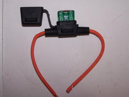

Or get rid of all 3 at once and have a spare with one of these. Fit right in the same spot as the old fuse case.
