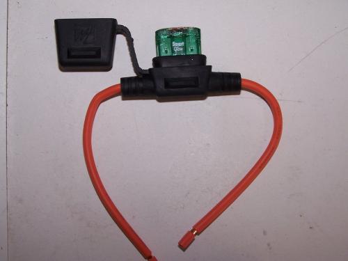

- AtLarge
Less
More
- Posts: 187
- Thank you received: 21
30 Sep 2011 16:52 #480638
by AtLarge
1973 Honda CL70-K3
1975 Kawasaki 350 F9-C
1983 Kawasaki KZ750-K1
1994 BMW K1100RS
2008 Suzuki GSX1300-BKK8 #1120
Replied by AtLarge on topic Fuse Voltage
Or get rid of all 3 at once and have a spare with one of these. Fit right in the same spot as the old fuse case.

- MFolks
Less
More
- Posts: 6650
- Thank you received: 540
30 Sep 2011 17:18 #480643
by MFolks
1982 GPZ1100 B2
Replied by MFolks on topic Fuse Voltage
A list of where to purchase “Blade” style fuses and holders:
www.waytekwire.com order.waytekwire.com/productdetail2/M50/...20%20%20%208%20FUSE/
www.rallylights.com www.rallylights.com/detail.aspx?ID=765
www.delcity.net/store/6!way-fuse-blocks/p_10822.a_1
