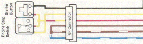

FileBAse has a wiring diagram for the KZ650 81 model:
www.kzrider.com/filebase/cat_view/100-19...1-kawasaki-kz-650-h1
It may help you realize where you may have a wire disconnected. Since your getting the dash lights, which should be on the Ignition switched Brown wire circuit, contact is being made up and out of the Ignition switch. I would check for the 6 wire connector, called 6P connector in the Diagram, shown just to the left of the Ignition switch. Should be in the headlight bucket.
