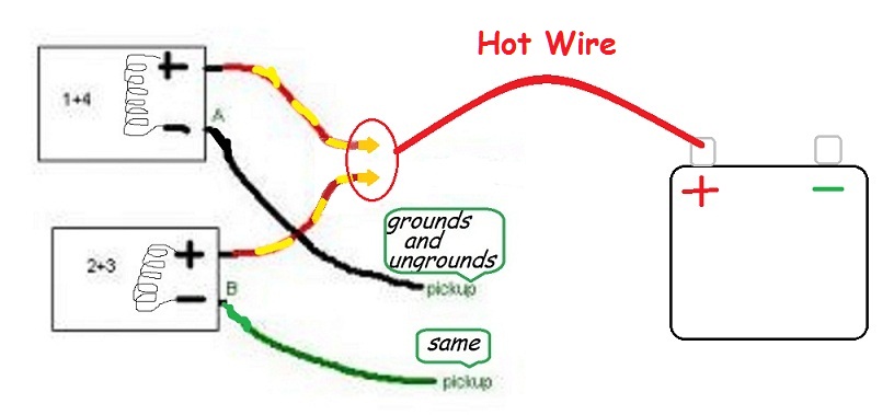

does anyone know how to bypass the ign. so I don't need a key to start my 77 kz1000? I'm trying to make the bike into a cafe styled bike. I just want to flip a switch and kick-start the thing. I'm thinking of taking out the starter to lighten it up a bit. Anyway i'll just start with that question.

Power to coil primaries is usually supplied via switched battery positive through the ignition and kill switches.
Could run a wire from battery positive through a toggle switch to the coil primaries.

thanks for the quick responses. Good visuals also.I'll give this a go.

If you unplug the ignition switch one wire should be hot, the other three NEED to be hot to run. B) Each one probably supplys voltage to different systems. Check your diagram.
