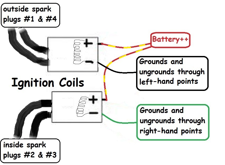

When I bought the bike I could have sworn the coil on the left was connected to the two cylinders on the left and the coil on the right to the right..
I had a mechanic come over to trouble shoot some electrical anomalies I was experiencing and he said the plugs were incorrect. He said the left coil goes to the far left cylinder and the third over from it..
Is this correct? Seems logical as one coil would fire the two cylinders on the compression..

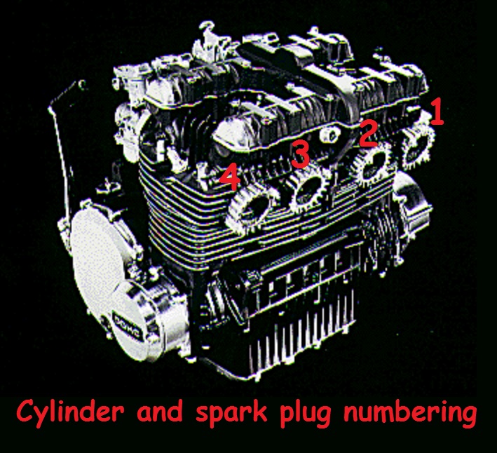

Sitting on the bike,the left coil fires the far left(1) and the far right(4).
The right coil fires the second from left(2) and the second from right(3).
From left to right 1234.

19 Aug 2011 18:01roy-b-boy-b wrote: Sitting on the bike,the left coil fires the far left(1) and the far right(4).
Welcome.
Ahahaa! thank you sir. We were both wrong! you rule!
