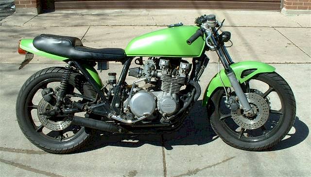

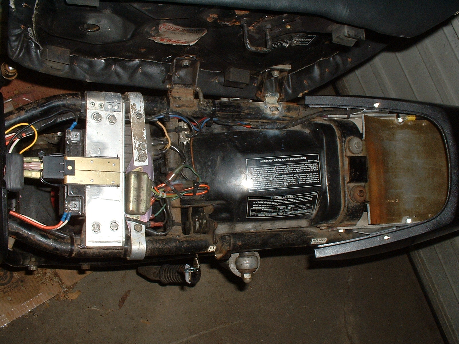

Here's a better view of the battery (cage still un-painted).
Here's where we stuffed all of the electrics under the seat.
Here's a similar treatment on a KZ650.

Unfortunately, the 1977 KZ650 cannot go battery-less. The green one above is also a 1977, that's why he had to go with a battery.
