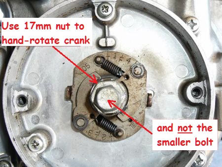

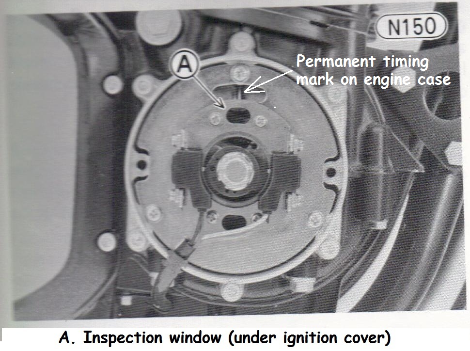

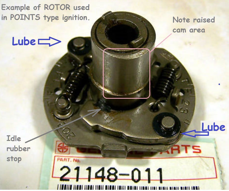

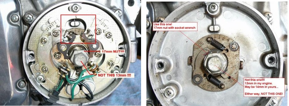

Revving okay in neutral, but lacking power at higher rpm, may result from the timing advancer being stuck in it's idle/retarded position, which could result from water/moisture under the points cover.
If not already done, would lube the timing advancer (especially the weights pivot points), which might be sticking, or maybe both clean and lube.
After removing only the points cover, access to apply lube may be done without further disassembly by going through the inspection window where the timing marks are viewed. Hand rotate the crankshaft by turning it with the 17mm nut (NOT the smaller 13mm bolt head) until each of the two pivot points may be in position to receive a drop or so of oil.
May assure correct operation with a strobe-type timing light, and watch the advancer quickly move back and forth as rpm is varied by blipping the throttle.
The advancer should NOT be rusted as shown in this example:

Make note of how the advancer is installed, as more than a few have been re-installed 180 degrees out(start the bike and see if it runs better).
