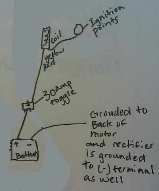

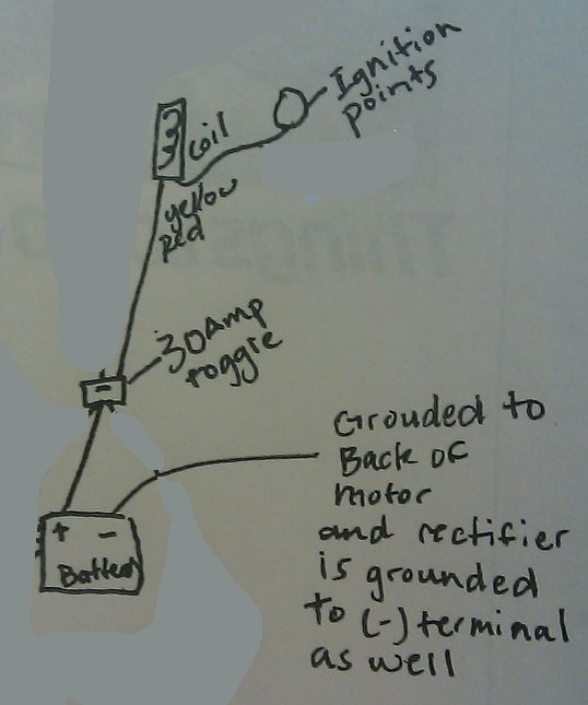

I am having trouble trying to wire my 1980 kz750g twin
please take a look at the wiring diagram i drew up.
It is true that all gauges and turn signals have been removed. All I have is what is shown.
The lights are working but I am not sure about charging system and ignition system
Also the keyed ignition has been replaced by a 30amp toggle switch.
If you have any suggestions why the engine wont kick let me know

RoycePHC1 wrote:
Attachment wiringdigram.jpg not found
...trying to wire my 1980 kz750g twin...wiring diagram i drew up...am not sure about charging system and ignition system...keyed ignition has been replaced by a 30amp toggle switch...If you have any suggestions why the engine wont kick let me know
Wiring diagram found in the FILEBASE:
www.kzrider.com/filebase/doc_download/490-kawasaki-750g-wiring
Engine should run (until the battery runs down) with the following ignition wiring:
Good Fortune! :)
