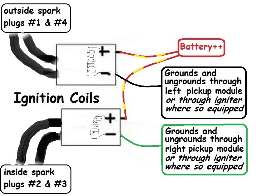

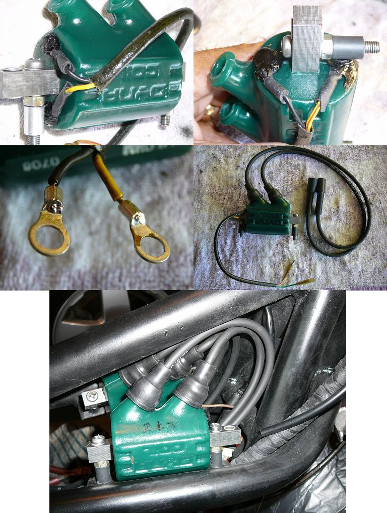

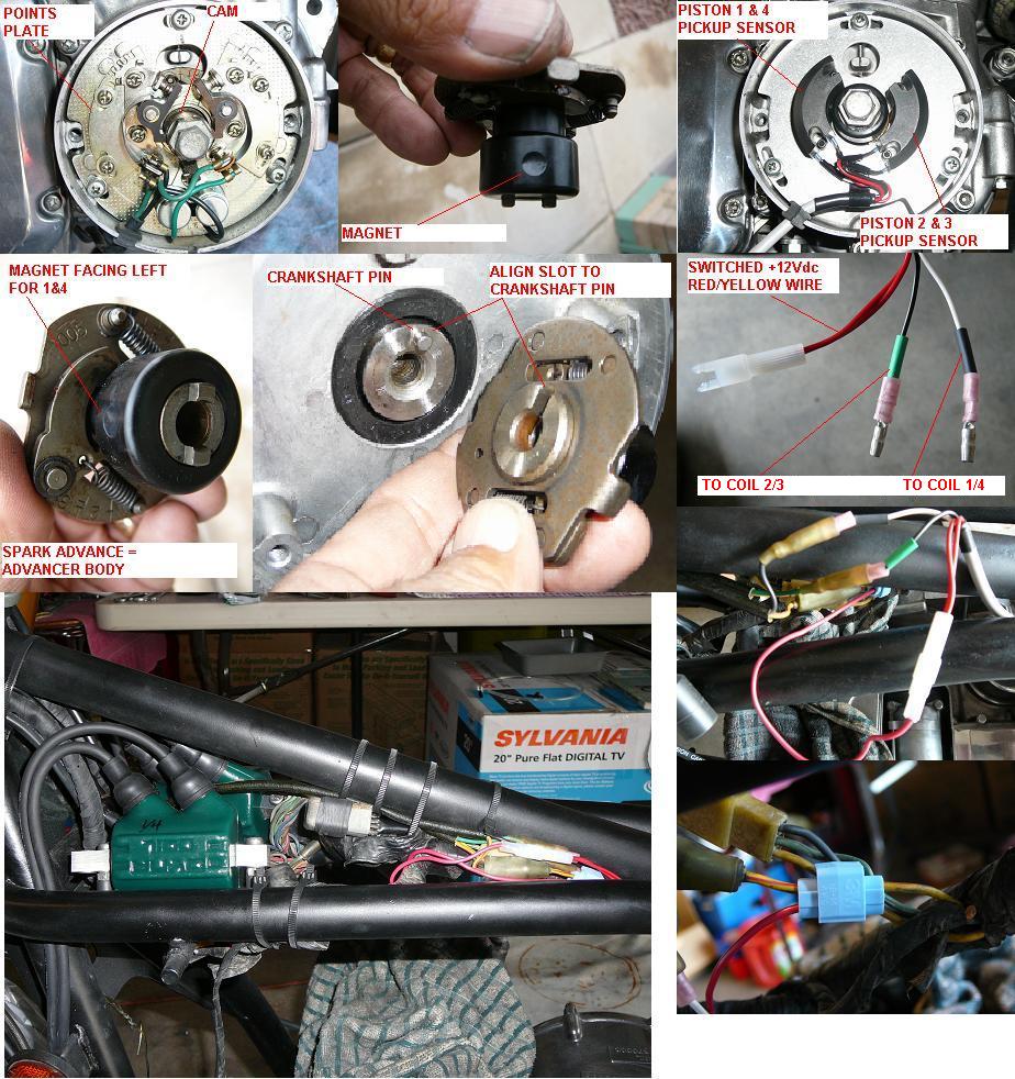

Maybe these will help.
Note spacers w/heat shrink around on frame screws under coil tabs....
Also, DYNA provides a switched +12Vdc conductor splice kit... I originally used it with no issues but solder and insulation over the solder joint is the preferred method.
