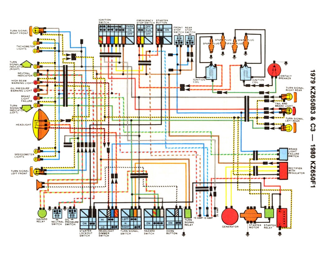

- Posts: 18568
- Thanks: 2101
Re: 1980 LTD650 Fuse Box
09 Jun 2011 22:13Mellvis wrote: ...Replace main fuse - fuse blows as soon as battery is connected, even with the key in the "OFF" position....
Perhaps a short in the wire or connector between the 20 amp fuse and the ignition switch, or a short inside the ignition switch itself.
Here's the wiring diagram from FILEBASE.
