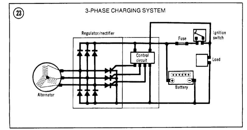

07 Jun 2011 15:04bangshift440rt wrote: My bike is 1976 KZ900:
I searched rectifier and didn't see what I was looking for so I'll just ask. Is there any reason I can't purchase a commercial rectifier such as this
Rectifier
in place of the $200 madness called OEM? A rectifier is nothing more than diodes (one way gates) converting the three phase AC from the stator to dc correct? I could then hook this commercial rectifier up to my regulator as if it were OEM, or use a commercial 12v regulator I would imagine. Has anybody done this? My rectifier looks like a previous owner had replaced all insulation on the wires with electrical tape after a fire (and this bike still ran when torn down!). What is the voltage and amperage coming from the Stator on a 1976 KZ900?
Yes, you can do that as long as you can isolate the output wires. If the ground of that unit is the body, then you should connect a wire to the mounting bolts to get a more reliable ground. If the body is positive, then you will have to be sure to isolate the rectifier body from ground.
The output voltage will vary on the alternator, but when it is regulated to 12~14v, the alternator will put out in the range of 20 amps or less, so that rectifier should be strong enough to handle it.
However there is one issue with using super-heavy duty rectifiers. They use up a lot of power. They will tend to have a larger forward voltage drop on the voltage. This forward voltage drop, along with the current, results in a large amount of power being converted to heat. (That's why the big heatsink, obviously). If your bike has plenty of alternator power, then it's not a problem.
This one may be more appropriately suited to the KZ: cgi.ebay.com/New-3-Phase-Diode-Bridge-Re...&hash=item2eb5a8bac8
This one has been used by at least one KZ owner and they reported it works well. It's body is isolated electrically. But it may need to be mounted to some aluminum bracket to act as a heat sink.
You can use the oem regulator with this rectifier, but most newer regulators for your type of alternator will be part of a one-piece regulator and rectifier.

07 Jun 2011 15:25bangshift440rt wrote: or use a commercial 12v regulator I would imagine
I believe the regulator on these bikes is an AC voltage regulator, not a DC voltage regulator? Maybe there isn't a difference...but the regulator is attached on the AC side of the rectifier.

07 Jun 2011 16:40DoubleDub wrote:bangshift440rt wrote: or use a commercial 12v regulator I would imagine
DD I think it is converted then regulated. At least with everyone I've seen. There are AC regulators as well though, this would be when there is no battery. Like in Sleds.

Not sure how that would be possible since the same three AC wires feed the regulator and the rectifier.

07 Jun 2011 16:59Have a look at it, first the paragraph form KAW, then the circuit. AC made, rectified, then regulated.DoubleDub wrote: Not sure how that would be possible since the same three AC wires feed the regulator and the rectifier.
I think all the Automotive stuff would be just like it.
