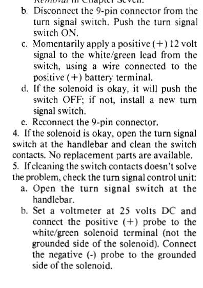

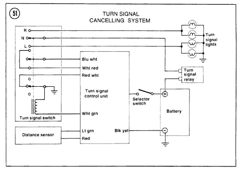

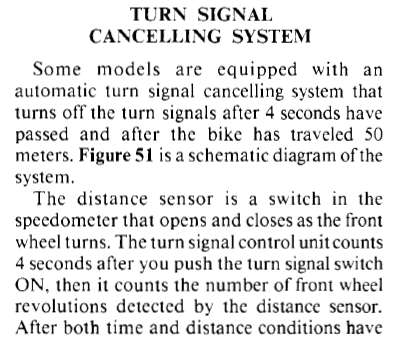

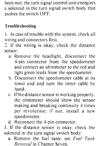

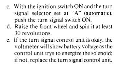

07 Jun 2011 16:22Pghpagan wrote: I have an '81 KZ440 LTD and the turn signal auto cut off doesn't work. Any help on how to fix this would be appreciated. Thanks.
The system is relatively simple, see if this is the same as its taken from the 550.

Ah, that makes much more sense. I thought the thing was wonky on my '81 440 LTD because it would cut off in turns or even before i turned. Silly me figured it worked based on bike tilt, not simply distance and a timer. 50 meters is hardly enough distance make it down the turn lane, then if you are caught by the light it will turn off in 4 seconds while you wait for the light to turn green again!

Thank you Motor Head that is excellent!!

The Distance sensor on yours might be on the upper end, at the Speedo. Look for a connector with the 2 wires, Light Green and a RED. It should be in a 4 wire connector inside the head light housing, coming from the Speedo.
Those later bikes like mine have a different sensor, and an Electronic, not Cable, Speedo.
