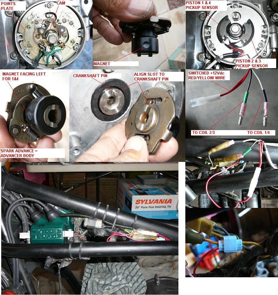

In the picture, the lower right hand corner shows a blue tap splice, these are good when new, but add moisture & corrosion will quickly set in, making this electrical connection intermittant.
I prefer doing a solder joint connection & then covering it with heatshrink tubing. I found out the hard way how bad these splices can be by having trailer lights go out during a heavy rainstorm.
Ever try to troubleshoot electrical connection problems under a trailer on the side of the road? You don't want to go there.
