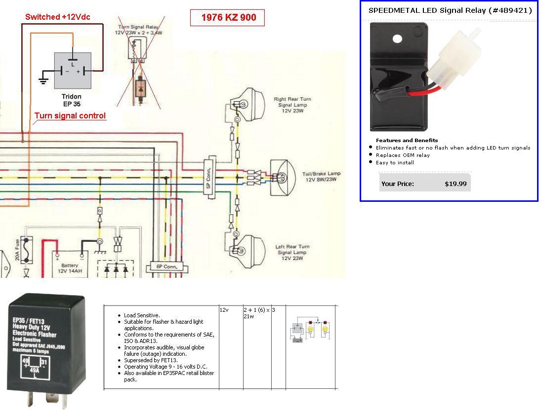

As DD mentioned, hard to say without knowing exactly what relay you have....
Just in case, here's how I did my KZ900 LED swap, works sweet, no issues.

i just bought an LL552 electronic flasher unit at autozone for 7 bucks worked great for me

OMR- thats what i need! Ok the problem i was having was that i ran that relay(flasher) off of the power connectors that were on the old flasher. I will try what you have on your diagram, and it should work just fine. I have integrated tail light, markers on the rear cowl, and turn signals on the front of the bike also...(i like to be seen),
