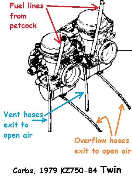

This pic is of oem '79 KZ750-B4 carbs from kawasaki.com.
Identity of the hoses is just guess-work on my part, and could be wrong.
According to kawsaki.com, this model was originally equipped with a manual style (not vacuum) petcock.
