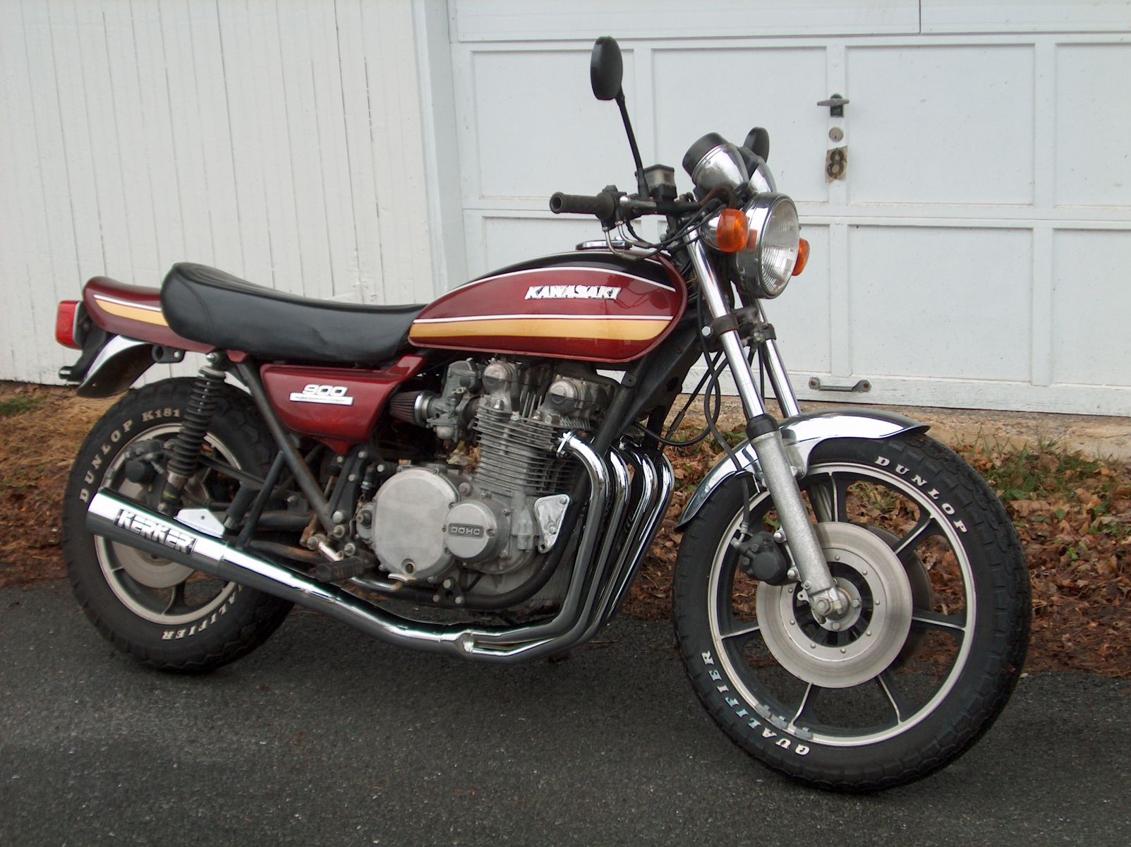

Pictureo of bike is nice. However I need pictures of signal lights. The front are different from back on my bike, is that the way it is suppsed to be? I could use some help, thank you. Tony in Toronto.

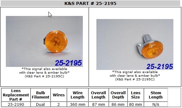

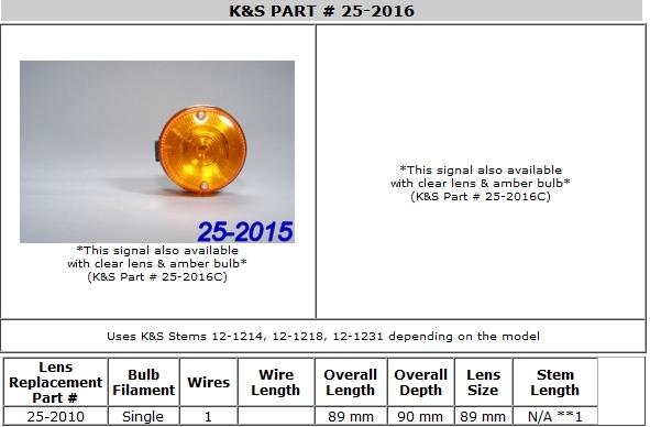

The dualelement,flat lens goes in front and mounts to the handlebars on a LTD.
Single element regular lens in rear. Roy

Thanks for the picture. Ihave now the 25-2195 lights in the front and the 25-2015 lights in the back. Is that the way it came from factory? Thanks, Tony.

mopguy wrote: Thanks for the picture. Ihave now the 25-2195 lights in the front and the 25-2015 lights in the back. Is that the way it came from factory? Thanks, Tony.
The Clickable Link I posted shows that Part No.# 25-2195 is front & #25-2016 for the rear for a '78 KZ1000 LTD.
